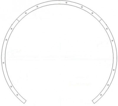

Hi Guys try this out for the Tiger 1 protection ring template. I got it from the RCU site and used it on my Tamiya Tiger 1. I downloaded it and then got it photocopied but reduced by 5% to get a better fit on my Tiger. Any issues let me know.
Alan
Alan

Hi This is ok for the Tamiya Tigers but the HL versions the turret spins of centre . You can fit this ring but you must alter the ring on the bottom of the turret . If you dont the turret wont spin it will bind on the ring. I know that they were in 3 segments and I think they had several bolts to hold them . However not all bolt holes were used and the ones not used were filled . But great ring pattern
Andy
Andy

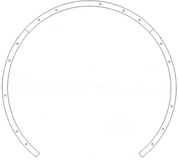

I have issues with it... it doesn't show where to drill the holes.tankman wrote:I got it from the RCU site ... Any issues let me know.
Alan
Each segment of the ring had 7 holes, and 5 of them were filled with cone-head bolts. These bolts have no surface detail, so they look like nothing at all when they are installed. The only detail you need to add is the two unused, open holes in each segment.
This is a profile of the ring and the bottom of the turret. All dimensions are in millimeters, so you must divide by 16 or 35 or whatever. The distance 1160 is measured from the turret axis:
You can see an open bolt hole in that profile.
Here is the ring seen from above, showing the 6 open holes:
And a view of one segment, with precise measurements:
David

Hi , Excelent info mate , wish I had the measurments of the holes when I fitted my turret ring . I have the seven bolt holes and five used with the other two filled. This info will greatly help anyone fitting this ring . Ive gota get my Tiger sprayed and the post finished . But all remember this ring wont fit streight onto a standard HL Tiger 1 . You need to alter the turret base .
Andy
Andy
